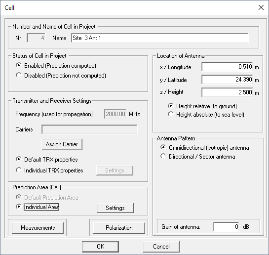

To retrieve a calibration file (.cal) after the prediction, a measurement file has to be assigned to the corresponding transmitter. Only one measurement route can be assigned to one transmitter. In the image below it is shown how a measurement file can be assigned to a transmitter.
The Measurements button is used to assign a measurement file
(.fpp, .fpl, .fpf
files are supported) to the selected transmitter. The measurement file must contain
measured data from the selected transmitter only. Superposed measurement data from
several transmitters is not supported. When the measurement data is in path loss
format (.fpl) cable loss must not be included. In contrast to
this, cable loss is expected as included
when measurement data is available
in field strength or power file format. Antenna gain is always expected as
included

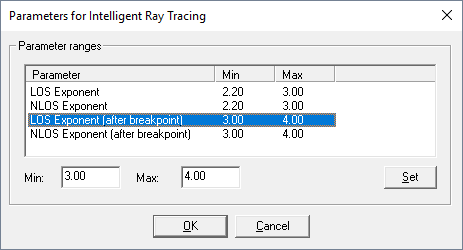

The range of the model parameters can be defined in the Model settings tab. As larger the range is, as longer the calibration will take. The model parameters depend on the selected propagation model, each model offers individual model parameters.
The model parameters can be modified on the dialog. Depending on the propagation model the material database or the clutter/land usage database can be calibrated additionally. After clicking on Start, the calibration begins and the progress is shown with a progress bar. In some cases the calibration process does take up to 1 hour.

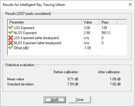

After a calibration has finished the results are displayed in a table.
The model parameters listed in the table can now be transferred manually into the project settings of ProMan and the project can be recomputed to achieve better results based on the new model parameters. By clicking on Apply, the material properties (as far as they have been calibrated) are applied to the vector / material database.
The message box shown above gives also information about mean value and standard deviation from measurements to predictions before and after the calibration. Depending on the optimization method different results can be obtained.
