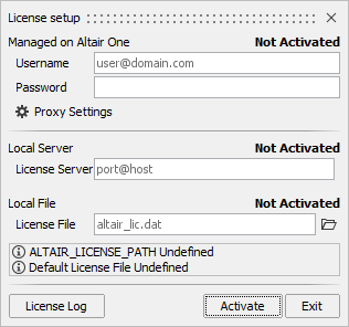

License setup window
The License setup window has five areas:
  • Managed on Altair One
    If you want to use the license from Altair One, then you will log in by entering:
    • Username (email address)
    • Password
    Potentially, if your company uses a proxy for internet access, then you will enter the proxy configuration settings using the:
    • Proxy Settings button
  • Local Server
    If you have a network license, then you will use the following syntax: port@host
    where port is the TCP/IP port number used by the license server and host is the name of the license server machine,
    in the field:
    • License Server
  • Local File
    If you have a standalone license, then you will enter the full pathname to the license file (.dat file) in the field:
    • License File
  • Information area
    This is an area where messages related to the license are displayed.
    It is possible to obtain information in particular on the environment variable ALTAIR_LICENSE_PATH.
    • If ALTAIR_LICENSE_PATH is not present, then this information will be displayed.
    • If ALTAIR_LICENSE_PATH is present, then you will see its contents.
  • License Log
    It is possible to obtain information about the license validity.
In order to save and use the information you have just entered in the License setup window, click on the Activate button.
Warning:
  • If you click on the Close button, no information entered and not previously saved will be taken into account and the License setup window will close.
  • If you click on the Exit button and no license is defined and active, then the License setup window will close and the Flux Supervisor will close automatically.
